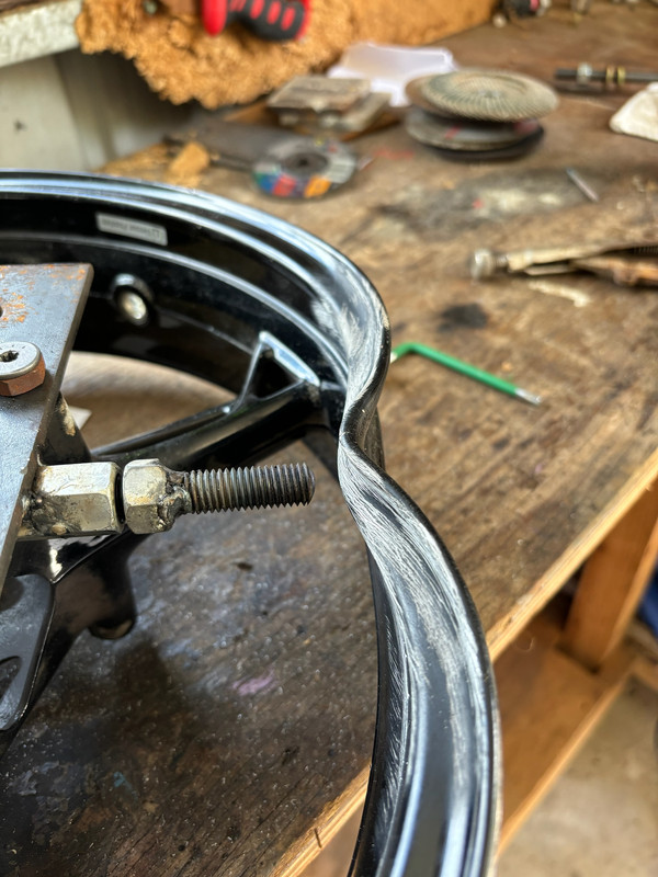

Johnno Posted November 23, 2024 Author Report Posted November 23, 2024 (edited) I agree, it looks bad. We've kicked ideas back and forth. The best effort I saw was a video of a chap made a semi circle out of timber and a used heat and a G clamp, turned out mint. Skin has made a contraption that attaches to the disc rotor bolts with a big bolt to push on the dent. He will probably end up buying that $495 Chinese wheel off Ebay. But, ya gotta know the guy, he's different, old Skinno. He hates waste, is very thrifty and likes a challenge. He said to me on the phone just now: What if we were those blokes that just hafta fix the wheel or we'll all die or some shit?? He told me the story: He was looking at this and a SuperDuke. He bid on this and didn't hang around. He bid 1250 GBP on it. It's a 2020, 12,000 klm, neat as a pin, the dent in the rim and very mild cosmetic damage, easy fix. Couple days later he gets a call ( he missed out on the SuperDuke ) he's the highest bidder. Bloke says he wants 3600 GBP. Skin told him he was crazy and his words " carried on like a pork chop, a bit " guy says he'd make a few calls. Gets back to him and says: So, 1240 GBP ? ( $2400 ) OK.. They're 30 grand AUD new here.. I'd have already ordered the Chinese wheel if it were me.. And maybe tried to fix that dented one just for the lols Edited November 23, 2024 by Johnno 1 Quote

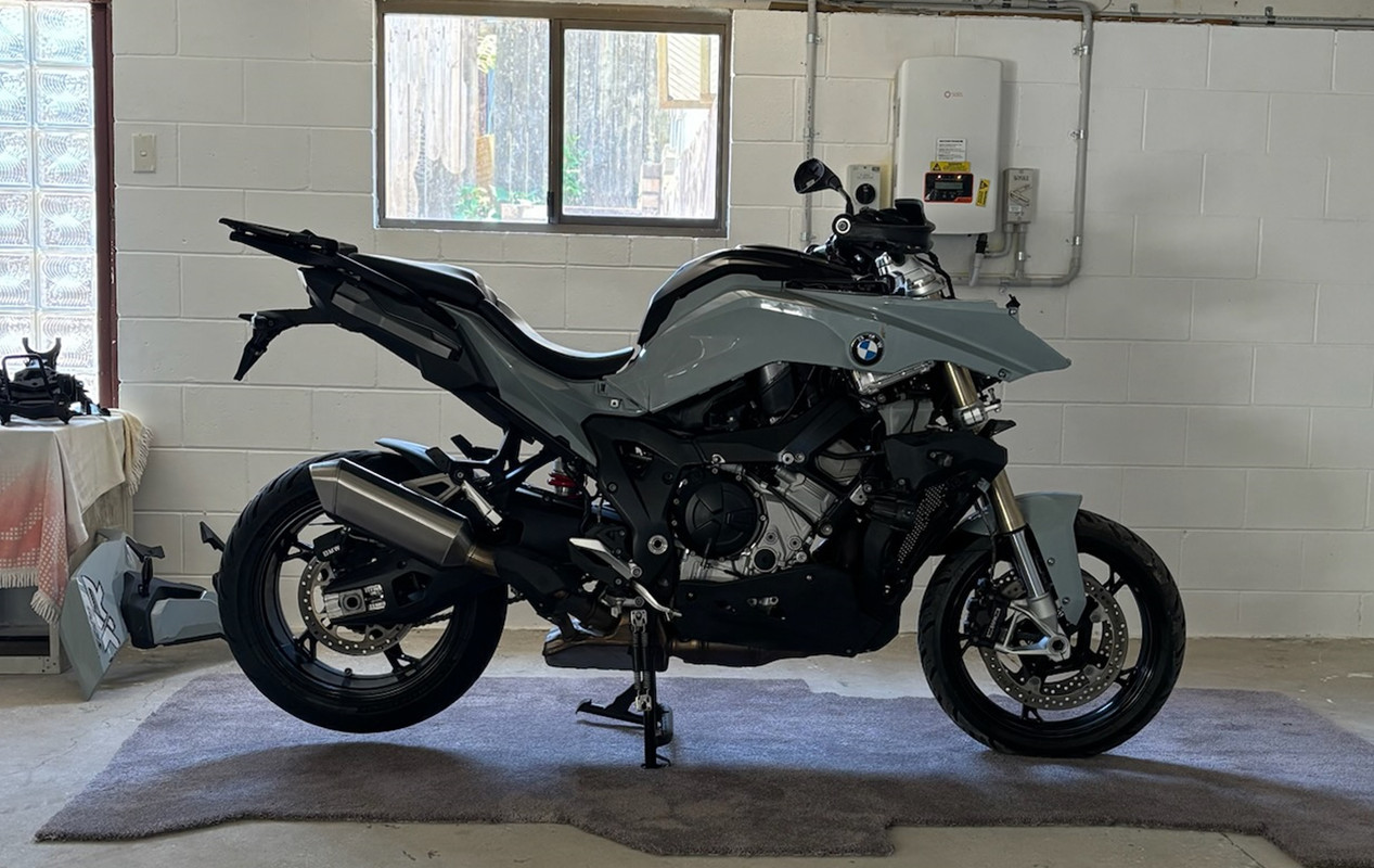

Johnno Posted November 23, 2024 Author Report Posted November 23, 2024 As I said, my first reaction was Chinese wheel from Ebay, under 500 bucks shipped. But for clarity, it is this guy.. 3 Quote

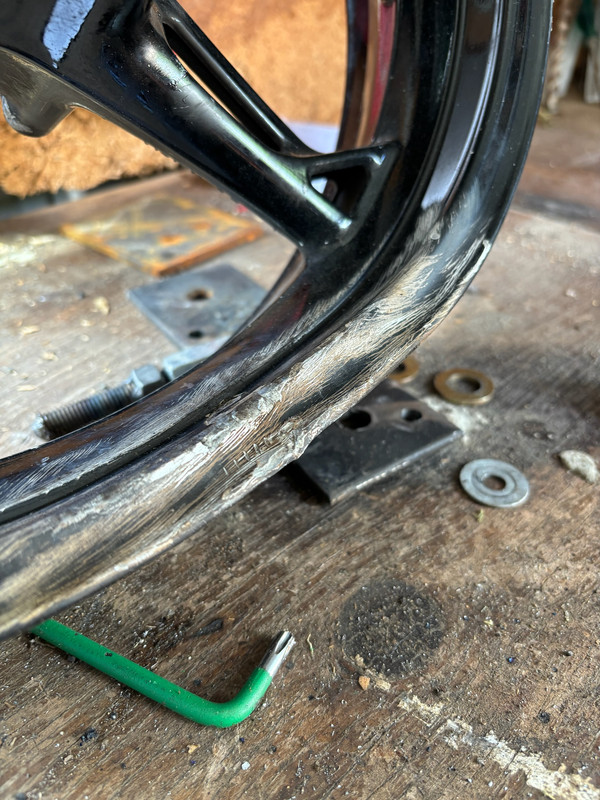

Johnno Posted November 23, 2024 Author Report Posted November 23, 2024 (edited) RESULT! Cracked. New Ebay Chinese wheel ordered. Edited November 23, 2024 by Johnno 1 Quote

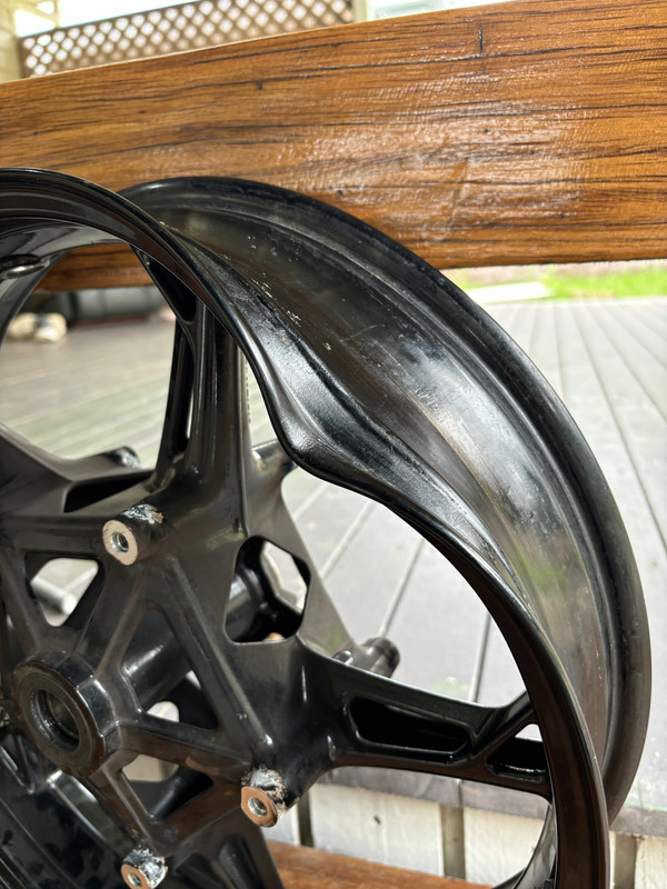

Johnno Posted November 23, 2024 Author Report Posted November 23, 2024 Although he's sent me this, says it rolls like new. Still ordered a new China wheel. Quote
ssray Posted November 23, 2024 Report Posted November 23, 2024 I've fixed a smaller less awkward dent. Soap on the one side and heat on the other, when the soap goes black it's kinda hot enough to have annealed?) it and we bashed it straight, if it cooled too much I would have repeated it. It was a old k100 BMW wheel, which are quite soft as standard 1 Quote
Gobert Posted November 23, 2024 Report Posted November 23, 2024 It looks like he didn't use any heat? I sent a wheel away for repair recently by one of the UK specialists and the buckle was nowhere near that bad .....the spoke still cracked.....after it came back with a weld repair, it spun near perfect but I couldn't bring myself to use it knowing how it had been repaired...........into the scrap pile it went. That's the same wheel as quite a few BM's.......thought it would be easy to get one. 1 Quote

jaycee Posted November 23, 2024 Report Posted November 23, 2024 4 hours ago, Johnno said: RESULT! Cracked. New Ebay Chinese wheel ordered. I could have put money on that happening. Quote
Johnno Posted November 23, 2024 Author Report Posted November 23, 2024 (edited) 6 minutes ago, jaycee said: I could have put money on that happening. We all did. He hoped the heat would help but that was a big sharp edged dent. Looking at the finished product I think he did rather well. Edited November 23, 2024 by Johnno Quote

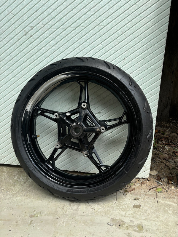

Johnno Posted November 25, 2024 Author Report Posted November 25, 2024 Tyre fitted, holding air. Ready for paint 1 1 Quote
